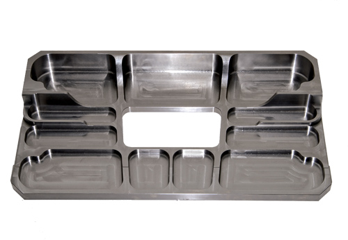

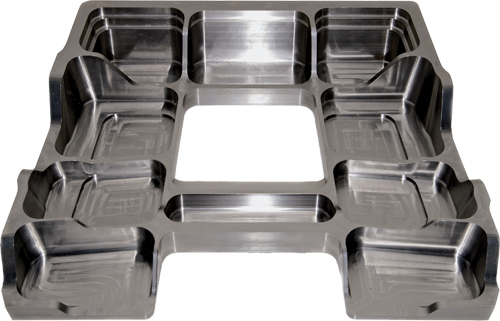

titanium aircraft component
The titanium aircraft components shown in the first two photos are typical. They feature numerous pockets with thin floors and walls. The walls often have stepped sides and contoured profiles. When cut from solid billets, these parts require substantial roughing operations in which the goal is to hog out material as efficiently as possible. Subsequent finishing operations, however, must produce smooth surfaces and hold dimensional accuracy.

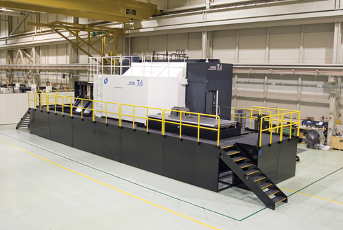

Makino's T4 HMC
The surge in demand for titanium machining capacity will be met by machine tools designed specifically for this application. Makino’s T4 HMC is representative of a trend toward large, powerful machines with a single spindle.

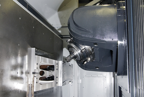

The A and C axes in the spindle head provide five-axis machining capability. The tool in the spindle has a gage length of 150 mm and is 80 mm in diameter. It and has five flutes with seven inserts per flute.

The centerpiece of the developments introduced at the event was the T4 five-axis HMC. This is currently the largest machine in the T-series, a line designed specifically for titanium aircraft parts, such as edge frames, pylons and bulkheads. (A somewhat smaller model in this series, the T2, is also available.) The T4 features all five of the machining technologies that work together to provide the advantage that overcomes limited metal removal rates and insufficient tool life.
The T4 is a large machine. It provides X, Y and Z travels of 4,200, 2,000 and 1,000 mm, respectively, and it can hold workpieces weighing as much as 5,000 kg. Adding to this impression of size are the massive column and bed structures, which the company says are necessary for rigidity. The other technologies, particularly those for reducing vibration, rely on this underlying rigidity to achieve their full potential.
The spindle is described as compact, but that is in comparison to a gear-driven spindle of equal capabilities. The T4’s direct-drive spindle is the most powerful the company has produced, providing higher torque, horsepower and clamping force than any predecessor. The spindle head also provides rotary motion for five-axis machining. Rotation is ±110 degrees in the A axis and 360 degrees continuous in the C axis.
The spindle also represents new technology for controlling chatter-causing vibration from heavy cutting forces. This is important because excessive vibration is the primary culprit in cutter wear and failure when machining titanium. Cutting tools for titanium are a major expense in the machining process, so increasing tool life has a direct effect on the bottomline. Makino’s Autonomic Spindle Technology addresses the spindle vibration issue. Sensors built into the spindle measure displacement caused by excessive cutting forces and transmit the data to the control unit. Algorithms in the control software process this data at high speed, and machining parameters are adjusted almost instantly. The response is usually a lower spindle speed (rpm), but a higher spindle speed is possible if it is nearer to a “sweet spot” in the machine’s dynamic resonance.
