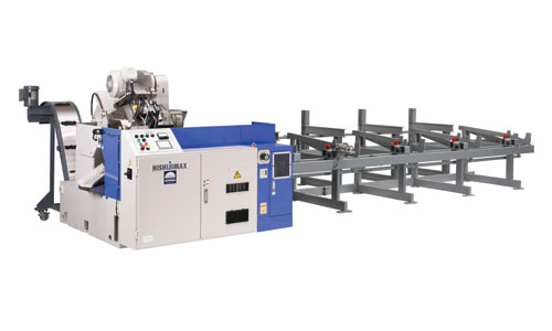

A single Nishijimax CNC Carbide Cutoff System can replace three to four production saws. Available exclusively from Pat Mooney Inc.
Facebook Share Icon LinkedIn Share Icon Twitter Share Icon Share by EMail icon Print Icon
Related Suppliers
A single Nishijimax CNC Carbide Cutoff System can replace three to four production saws. Available exclusively from Pat Mooney Inc. – The Saw Company, these systems cut more parts per hour and more parts per blade than a standard production saw.
Designed for fully automatic cycles, all Nishijimax saws feature auto loaders and barstockers. After a bar length has reached the remnant end, the loading table introduces a new bar on the in-feed conveyor. The gripper vise locates the bar and feeds it into trim cut position. During this cycle, the remnant end is discharged into a scrap bin, and the trim cut is made and discarded into a scrap bin. The machine then feeds to proper cut length and continues production. The machine will continue to cycle as long as bars remain on the table or until a predetermined number of cuts are made.
With Nishijimax’s exclusive NC saw spindle feed axis, a precise feed rate is set automatically and input chip load is maintained. The saw blade feed rate is controlled via an AC servomotor with encoder, a Mitsubishi programmable servodrive and a precision ballscrew. Compared with hydraulic systems, there is no fluctuation for temperature or condition of the oil. According to the company, job setup takes less than 5 minutes with the CNC controller.
Other features include the original powder metal saw blade brake for zero vibration when the blade enters the cut, a gearbox oil chiller to maintain constant gearbox temperature throughout 24/7 operation, thereby extending the life of the gearbox and the saw blades, and an easily accessible oil pressure adjustment valve. Magnetic and drag-style automatic chip conveyors are offered as options.
Nishijimax blade capacities range from 2.75” to 9.00”.
