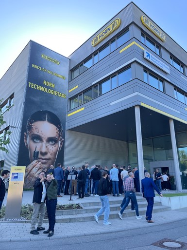

Last May, 3,300 visitors from 33 countries attended Horn Technology Days at the company’s headquarters in Tübingen, Germany, many being owners and managers of machine shops around the world. Source (all photos): PM
But beyond that, it makes even more sense for me to visit this event (a mini trade show in and of itself) because much of the company’s cutting tool technology is very much in Production Machining’s wheelhouse.
In fact, this was my second time attending Technology Days, the first being two years ago as I reported about here. This year, 3,300 visitors from 33 countries attended, many being owners and managers of machine shops. I again felt honored to be the sole U.S. manufacturing editor to be invited on the trip.

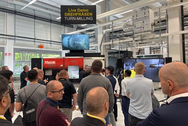

Live cutting demonstrations are a hallmark of Horn Technology Days events.
-Turn-milling. A CNC lathe having a B-axis milling spindle combined with the proper tooling can result in improved machining efficiencies. Using a spinning milling cutter rather than a static tool is often used to machine eccentric forms which might be challenging (or impossible) to create with a typical turning operation using a static tool. Turn-milling operations are often performed at a low working speed, so it can be helpful for large parts even though this might extend processing time. It is said to be a very repeatable process and can eliminate the creation of long, stringy chips that can wrap around a tool and/or workpiece which could reduce tool life and possibly mar the part.
A variety of turn-milling operations were performed on this intricate part during live cutting demonstrations at the event.
This presentation was followed by a live demonstration on the company’s production floor performed on a Mazak i-100H S Integrex. Which is a nice part of this program because many other presentations were complemented by subsequent live cutting demonstrations.

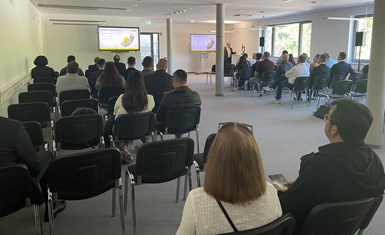

Attendees could take in multiple presentations about new cutting tool technology and machining processes such as this one about turn-milling presented by Horn USA’s Todd Schneider.
The tool is designed with chip control in mind to offer high process reliability. The geometry extends far into the corner radius of the insert, which can enable chip control even with small in-feed settings. The geometry can be used universally for different material groups and is suitable for internal, face, copy and back turning.
In addition to the new geometry, the company has optimized the carbide blanks of the inserts as a teardrop shape, aiming for greater rigidity and a stabler cutting edge area. This can enable large, precise contact surfaces in the tool holder, which can result in greater rigidity of the overall system. Furthermore, the teardrop shape prevents the insert from twisting, which can lead to consistently precise positioning of the center height of the tool. With long tool overhangs, it is able to reduce deflection and minimize vibration during turning. Depending on the application and the diameter to be machined, Horn offers the inserts in three different sizes (types 105, 109 and 110) and different blank types. All types enable internal coolant supply directly to the cutting zone. The Horn tool portfolio contains around 2,500 different standard variants of the Supermini and additional customized solutions.
