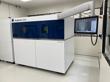

DK: What specific features of the Trumpf machine made it attractive for your company’s needs?
ML: The Trumpf TruPrint 3000 is robust and stable machine which can be successfully use for industrial 3D printing. It features twin 500-watt fiber lasers and a 300-mm-diameter by 400-mm height build envelope while enabling external powder management.
Trumpf twin laser printer
The Trumpf TruPrint 3000 at Paul Horn’s headquarters in Tübingen, Germany, features twin 500-watt fiber lasers and a 300-mm-diameter by 400-mm height build envelope. Source (all photos): PM
The machine is equipped with one build cylinder and two supply powder cylinders which can be quickly exchangeable. This feature make it well suited for multi-material applications because it eases material changeover while avoiding powder cross-contamination. The separate sets of build cylinder and two supply cylinders can be used for each dedicated powder material and, in this scenario, there is no need to clean them.
We selected the TruPrint 3000 based on performed benchmark testing. The 3D-printed parts that came off the machine demonstrated the best quality (surface roughness, part density and so on) among other machines available on the market at that time in 2022.

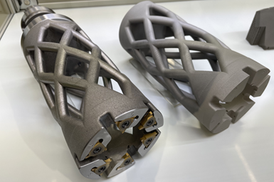

This bell-shaped, hybrid milling tool includes very complex, contoured internal coolant channels which can be fabricated only via additive technology to more accurately deliver coolant to the point of the cut.
DK: What are the key specifications relative to the hybrid tool shown in the photo to the left that was on display at Technology Days?
ML: We printed the body of this bell-shaped milling tool from 1.2709 tool steel. For this tool, the full build envelope consisted of six tool bodies and the total build time was approximately 61.5 hours at a layer thickness of 60 microns.
The tool includes very complex, contoured internal coolant channels which can be fabricated only via additive technology to more accurately deliver coolant to the point of the cut for optimal cooling and chip evacuation. In addition, this process also reduced overall tool weight. An advantage of this is less strain on a machine tool’s spindle and quicker tool acceleration and deceleration.

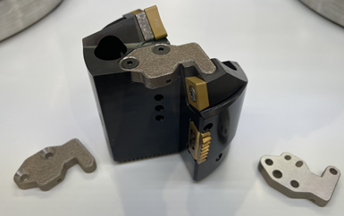

The 3D-printed cassette for a tool for oil-field applications provides the proper volume of coolant to the front of the tool.
DK: Were there any other examples on display at Technology Days of tooling components with complex internal coolant passages?
ML: Another example is a printed coolant attachment for a new cassette tool for oil field applications. This type of complex contoured internal coolant can be only fabricated via additive manufacturing technology. This cassette provides the proper volume of coolant to the front of the tool and cools the most exposed cutting inserts to avoid fast insert wear while optimizing the machining process.
