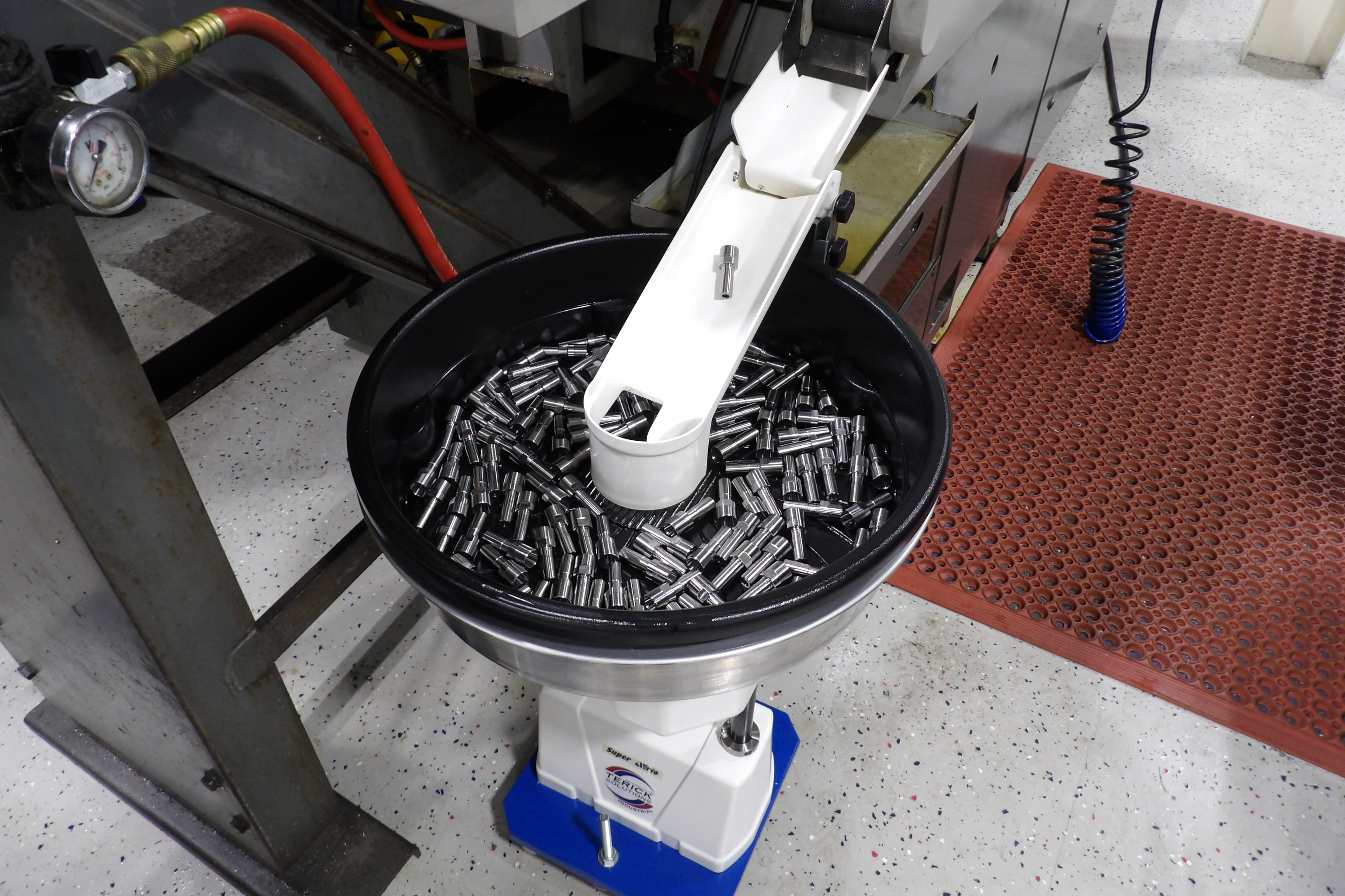

This parts accumulator especially for Swiss-type lathes is designed to prevent dents and scratches on workpieces as they fall from a machine’s chute into a receptacle plastic tray. Because the tray rotates clockwise, it moves parts away from one another, providing clear space for the next workpiece to drop onto the tray without touching another part. Source (all photos): Diamond Machining Industrial

The Super Ario unattended automatic workpiece accumulator, which is available in small footprints of 350-mm, 500-mm and 700-mm diameters, is unlike a bin design whereby parts fall into and on top of each other. This accumulator is designed to prevent dents and scratches on workpieces as they fall from a machine’s chute into a receptacle plastic tray. Because the tray rotates clockwise, it moves parts away from one another, providing clear space for the next workpiece to drop onto the tray without touching another part. The rotation speed can be easily increased or decreased to space parts properly.
Stuczynski describes the unit as a Lazy Susan on a motorized table on wheels. He says the unit is designed especially for Swiss-type lathes because of their small size and light weight. They are made for small parts that Swiss-types make.
“Anything that will fit in a Swiss will fit in a Super Ario,” he says. At Diamond Machining, the parts that fall into the accumulator are made of stainless, aluminum and mild steel and are about an inch to an inch and a quarter diameter. The longest part is about three inches long.

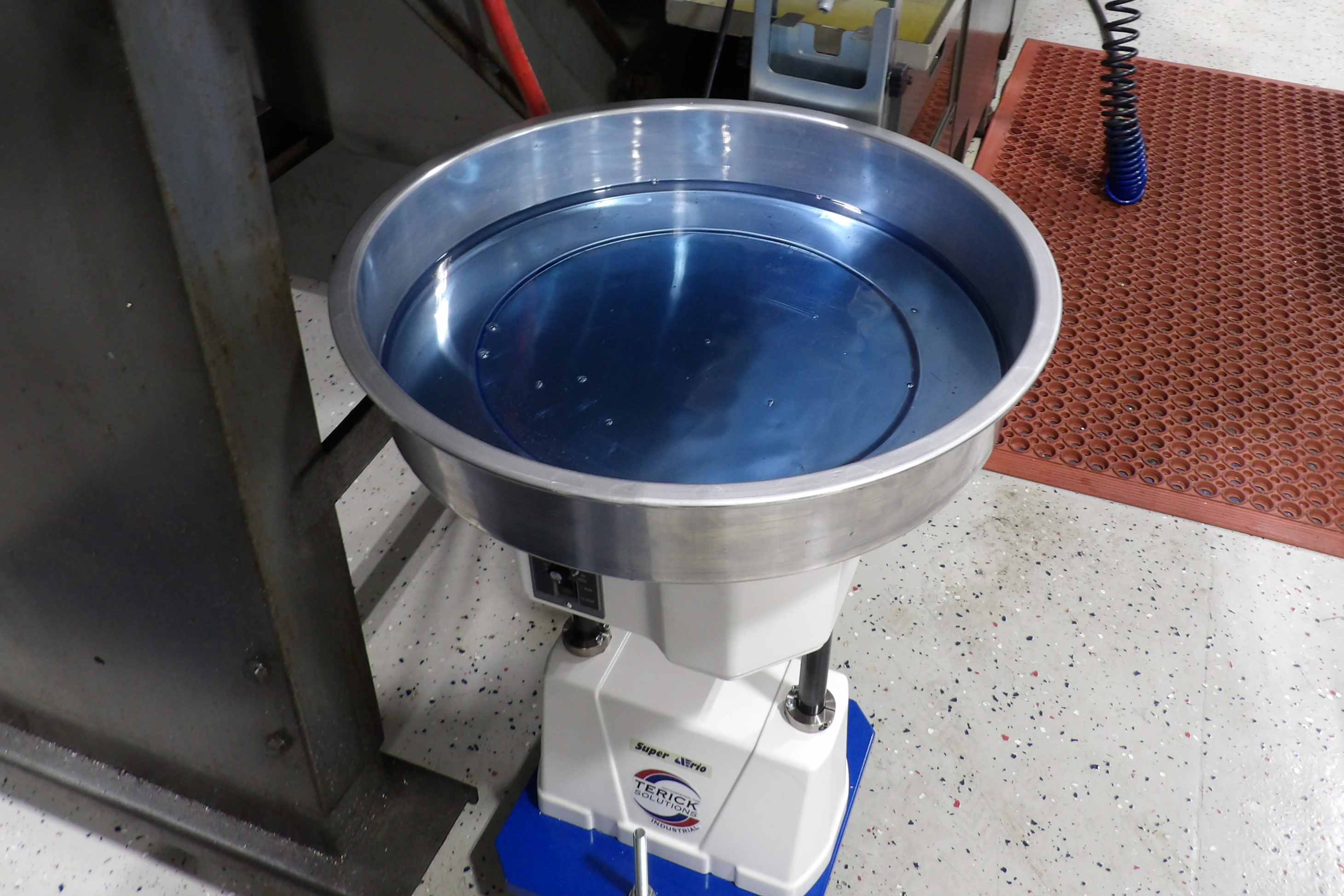

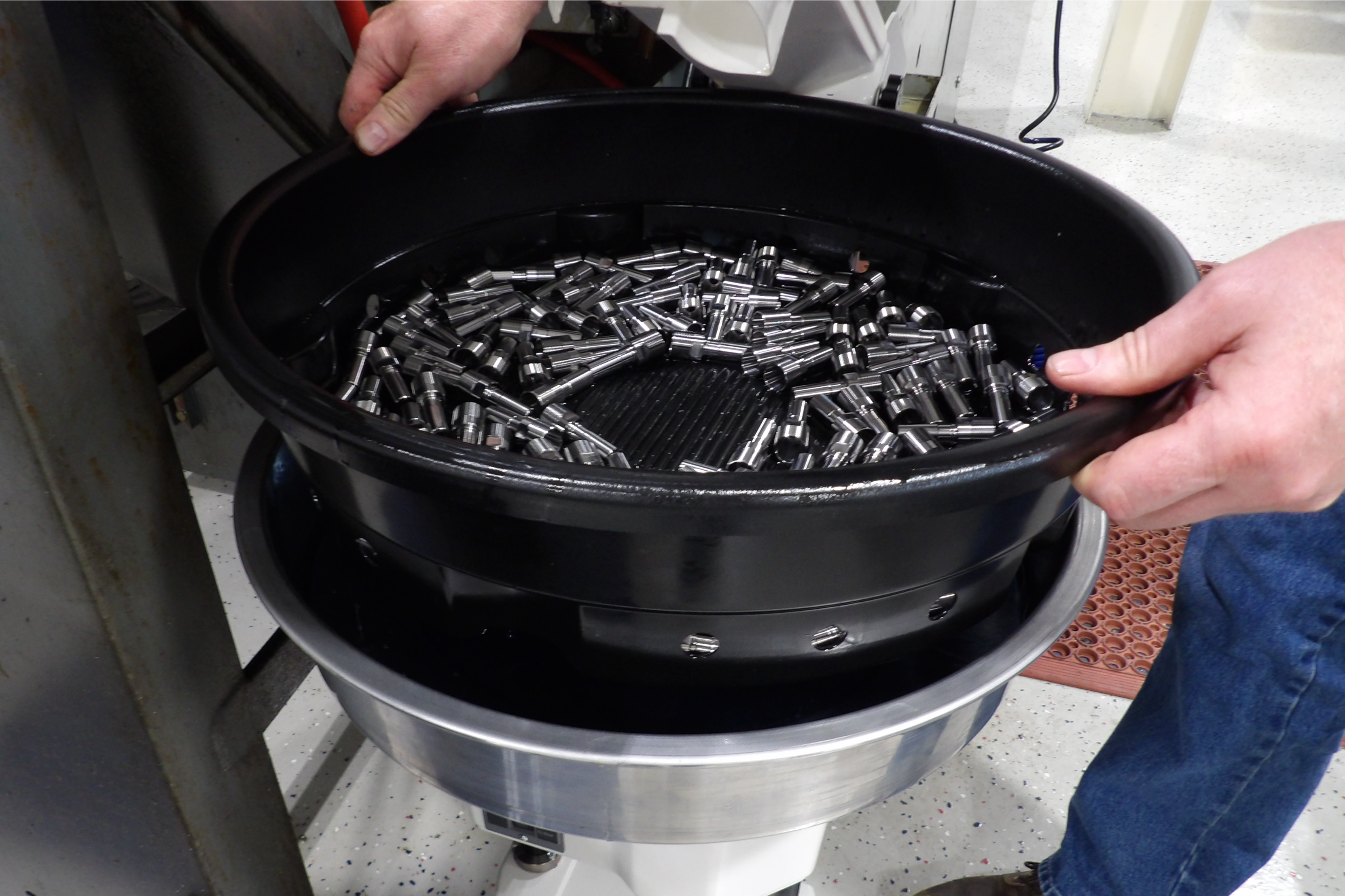

For example, Diamond Machining uses the accumulator to pre-clean as well as catch parts coming off the machine, which eliminates a cleaning operation for the shop. Cleaning solution can sit in the aluminum tray, so as the parts fall in, they are being cleaned. The plastic tray contains vents that are intended to drain the solution.
